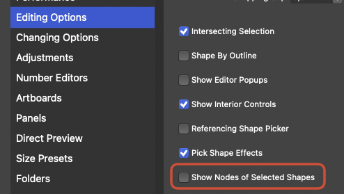

@Ingolf If I understand correctly, you just need to disable 'Show Nodes of Selected Shapes' in Preferences > Editing Options.
@b77 said in Hiding nodes when selecting a group:
Bingo - thanks!
