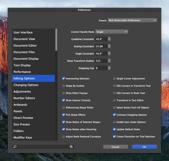

@b77 I appreciate your response though I don't think we're talking about the same exact thing. I have "select nodes from all objects" off and have always had that off because I like the ability to select something generally and then go in with a selection drag and pick specific nodes and such without also selecting other shapes. Affinity has this as well and I always really preferred this method over illustrator, etc.
Something changed not for the better between build 25 and build 26 with this. I switched over to my mac intel computer that still has build 25 on it and was able to easily do what is lacking now in build 26

Even within the same initial selection shape, if you then generally grab that shape and then hold shift and try to drag-select a node and then try to again drag-select another node, it will not select ithere are my current relevant settings for build 25 on the mac intel machine:
