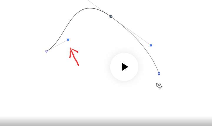

      Here in this recording
      1. While I drag the first node there is no handle visible.
      2. The fourth node should be a smooth node
      3. In first shape I think if the second node shows as symmetrical node would be better.
      This is my observation no. 2 is clearly a bug. No 3 This is not a bug. If a Symmetrical node shows as Symmetrical in context bar I think it would be more meaningful.

        @Jayanta-Das (1) is replicated, I will check the others, added this to the backlog.

          @vectoradmin Closing node With the recent update 1.1.026, I got this issue.

            @Jayanta-Das Yes, when closing with a cusp and very close control point, the stroke rendering can result in strange endings.
            EDIT: I try to see how to have the closing better.
              Anything related to this handle as it is created on cusp node?

                @vectoradmin I am thinking this because when the node close with cusp node the handle handle doesnot retract. You can see in this video when I move the handle closer to the node the issue solve to some extent.
