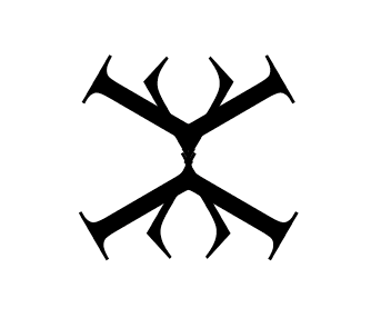

Hi all
Here is a easy way how to create interesting patterns,
It's an old trick, but it can still be useful.
you could:
Change the original Letter in a another one
Use a different Font, e.g. Script Fonts give nice Patterns
Try a Symbol Font
Convert the original Letter to Curves
(Menu > Object > Convert to Curves)
select all Nodes and move the Object on the canvas
(we do this because when you move the Original then,
the clones will move as well) -
and you could find your one Ideas
Here is the Video is 4:49
Letter for Pattern creation, re-upload0:00 to 2:10
create and arrange Letter for Pattern2:10 to 3:40
why convert the Letter to curves to move them3:40 to 4:49
how to use the Shape Picker Tool to switch between Fonts/LettersHave fun being creative
