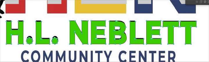

In a case where I have multiple shapes (letters) that I want to make all the same height or width, is there a fast way to grab all of them and perform the task of resizing height or width one time for all at once? If I grab all the shapes at once (they are ungrouped) and change the height, it only adjusts the tallest one.
@Boldline You want each letter of 'H.L. NEBLETT' (which I guess was split into characters and converted to curves) to be the same height with what else in the drawing?
@b77 in this case, the font I used to create the "H.L. Neblett" was close but not exact to the original font, so I had to go in and modify it some - expanding the font and editing the nodes. so I ended up with several letters that are not the exact height to one another - they are all off by a little. I realize there are other ways to do it - but the real focus is on the ability to grab several items and make them each individually the same height or width
Oh, I understand — you hand-traced over the bitmap image and the letters are not the exact same height.
No idea how this can be done faster than dragging two guidelines from the horizontal ruler and scaling each shape to them.
@b77 essentially - I used a similar font and expanded it and then moved around the nodes to get them to where they were in the original source letters. I don't think there's currently an ability in VS or another vector program that can do this - but I don't see why it could not eventually happen
@Boldline If you want to make objects of the same height (or width) use the Align Size options in the Alignment panel:
