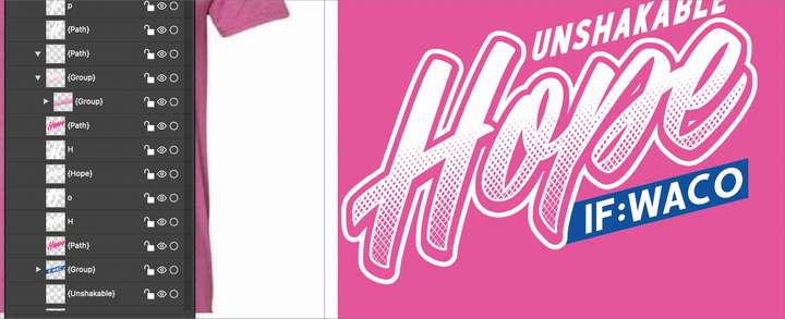

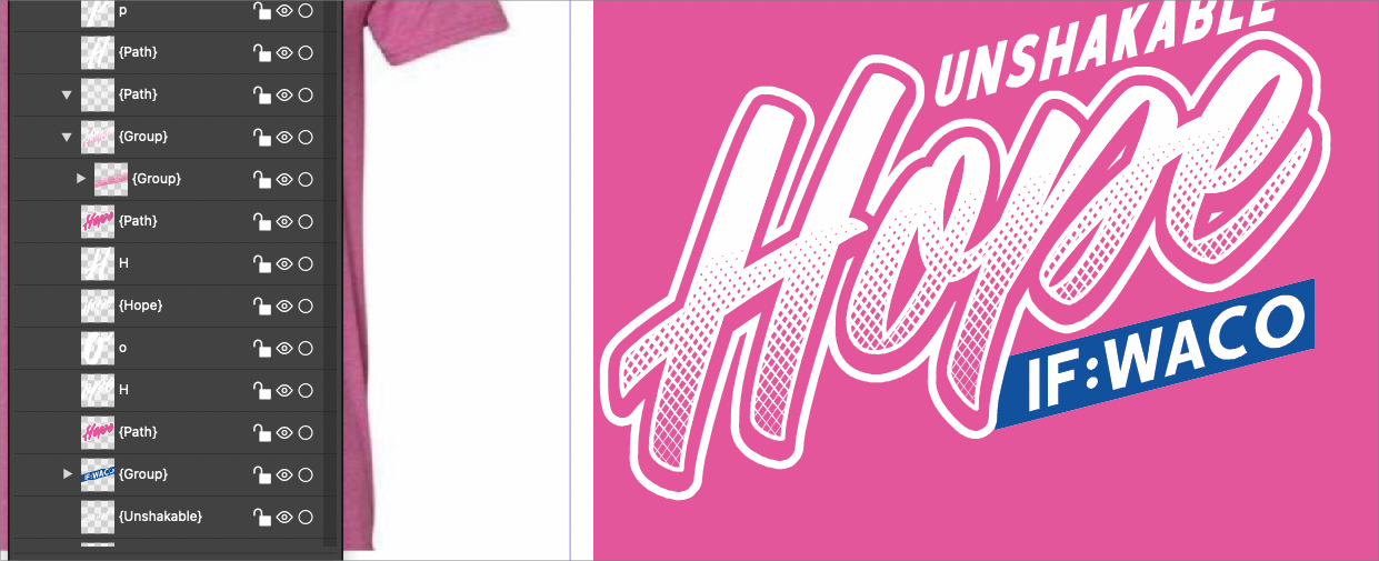

@vectoradmin forgive my slow understanding. I know I can use that selection mode to click on the clipping interior piece - I can also click and grab the interior clipped part by selecting it in the layer panel itself. Is there a way to use one of those selection options to select JUST the containment shape Because then I could copy it and paste in place.
Your solution works and I love that function to be able to convert one shape into another shape - but the only issue in this specific situation i want to use it is it's not going to be in the same placement as I need it
