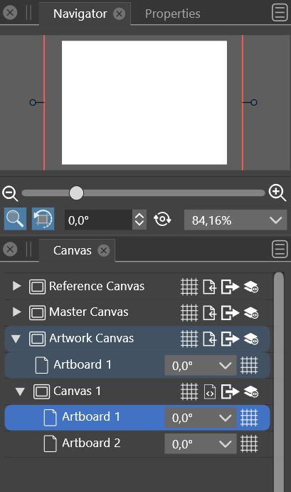

Again, I don't know whether this is a bug or whether this is a point I don't understand in VS. When I click on the "canvas" artboard where I did my scheme, I seen in the navigator panel & in the document content viewer an empty artboard.

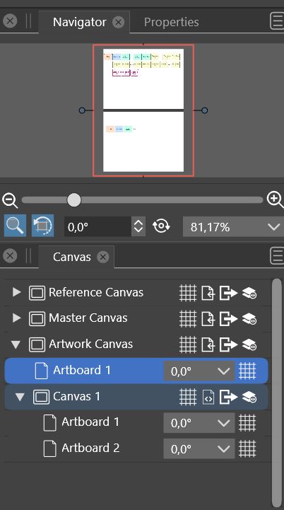

When I click artwork canvas I can see my two canvas artboards both in the navigator panel and the vieawer. Please, see below :

@PatrickM It is not a bug. A VS document contains multiple canvases, that are shown in a hierarchy (Artwork Canvas contains Canvas 1).
Canvases are not artboards: a single canvas can contain multiple artboards.
Only a single canvas is shown at a time.This allows to have multiple illustrations / designs in a single VS document, and to have symbols or other assets in an editable form on some other canvas where they are actually used.
