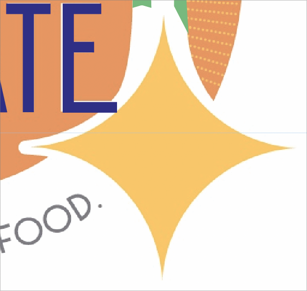

      If I wanted to recreate this yellow diamond, how would I do so in VS? In Illustrator I would make a square and turn it on it's end and then use what they call "pucker and bloat" to suck in the sides. I was looking into options in documentation and probably missed it. I'm sure it already exists in VS!

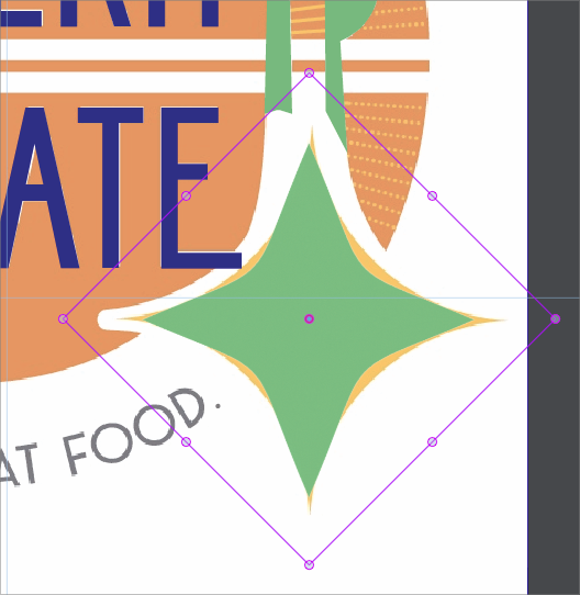

        @Boldline Distortion -> Circular Bump is the closest I can find, but it results in a different curvature of the sides.
        Also important to know: the sides of a rectangle (before convert to curve) can be bent using the Node tool.
          @vectoradmin Thanks - the distortion bump was pretty close. Is this something that could be added to the list for either improving the curve for or adding the pucker and bloat to VS in some other way? (not with that terrible name though!)
          The more I think of it - the distortion bump is already close - could another setting be added to that in order to set the curve more?
          0_1643873728528_426c490d-9c83-45c8-a9be-90b2a9c4681c-BLD 2022-02-03 at 02.34.53.png
