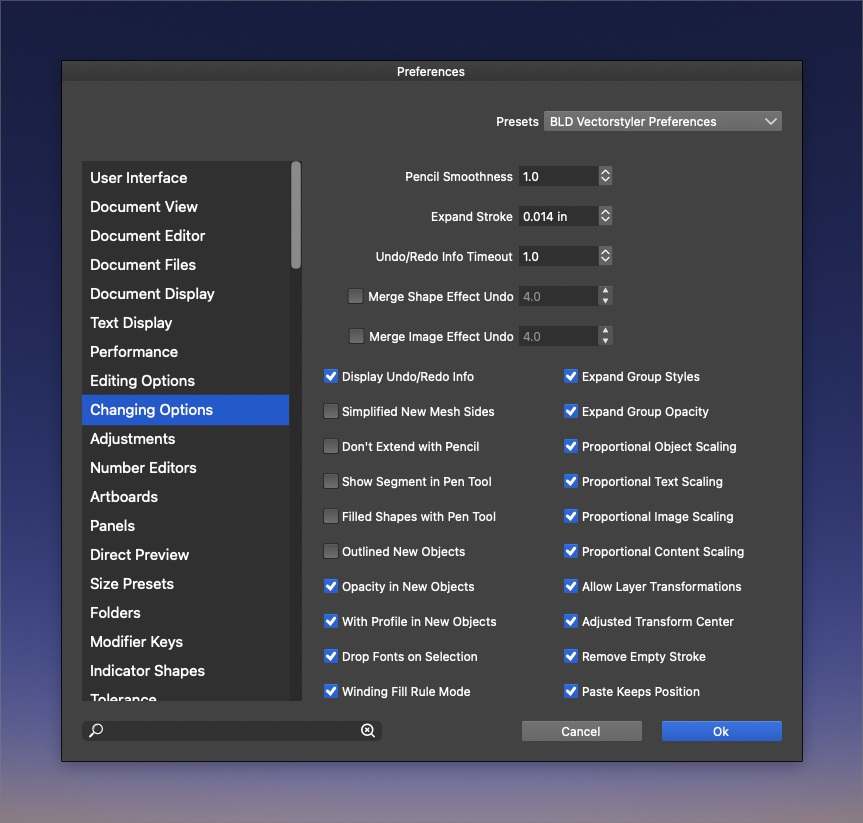

Frequently when I copy or cur something and then soon after paste it back, it often does not keep the original position. I think this like the other tools that randomly stop functioning because when I restart VS, it works again
Here is a video - only the first 45 sec are relevant as I thought I had turned off the recorder and it was not actually turned off.

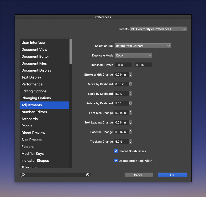

I have "paste keeps position" and "duplicate offset" set to ).0 for good measure
in preferences.
