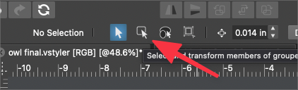

UPDATE: I think I found the issue - I was playing around with the second selection arrow - allowing me to move/transform members of a grouped item.... I had not put it back to the default.
This probably also answers where the "scale by distributing mode" is located - my original question on this thread
