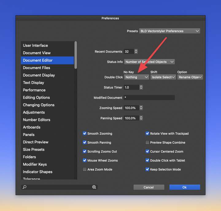

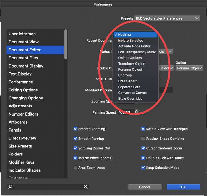

@vectoradmin Even when I have the double click sans modifiers set to none - I still can't double click to select live text.
@Boldline Set it for now to ‘Isolate Selected’ (the default) and text editing should work.
@b77 Where do I do that? Am I missing it?
@Boldline It’s the second in the list.
@b77 ok I get it now - I was looking for a literal "default" but right now "isolate selected" would be default - thanks!
