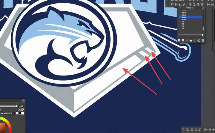

      In this example, I have a home plate that I want to change the color of the rectangle shapes inside the gray on the right side. I can't seem to find an easy way to access them without ungrouping the entire shape. I'd love to be able to double click to go into isolation mode, then use the shape editor tool to click on them shapes and alter them, in this case, change their fill color. Let me know if I am missing a step in the process! thanks

        @Boldline One approach: when the Transform tool is active, the context panel has 4 icons used to set what is selected.
        The first (arrow) is the regular selection mode.
        The second will select inside groups.
        Another approach: double click on the group to isolate the group. But this will allow selections inside that group only.
          @Boldline On Windows I use Control + Transform tool to select from inside a group.
          I also incorporate the Control + Alt keys to dig under a selection.
          Is it possible that you do have the equivalent key combination on Mac?
