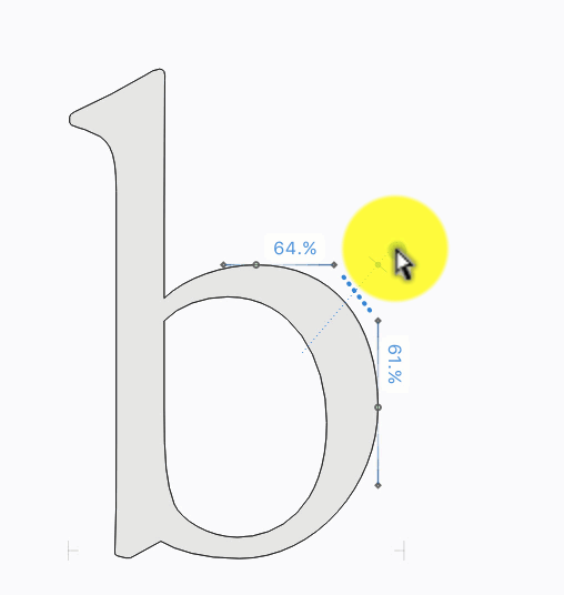

The Cmd key is available for something like this, but wouldn't Tunni handles for symmetrical editing of a curved segment be more useful?
@b77 said in Shortcut for pulling both handles on a non-symmetrical node:
I had to google "Tunni handles" lol. Yes that would be very helpful indeed. I don't know the purpose @Ingolf was requesting it for but the a shortcut for pulling both handles simultaneously on a non-symmetrical node would also be nice.

That tunni handle idea is excellent, I added it into the features backlog, for further down the road.
