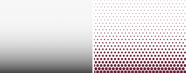

      @Subpath said in TIP - Halftone Generator - Bitmap to Vector graphics (.SVG):
      By the way, you can also control the halftone grid
      with a simple color gradient.
      @Subpath Ok - thanks for explaining the steps. I initially was not sure when you mentioned being able to control the halftone grid, if this was something inside VS or you were elaborating on the Halftone generator from Adobe. I get it now.
