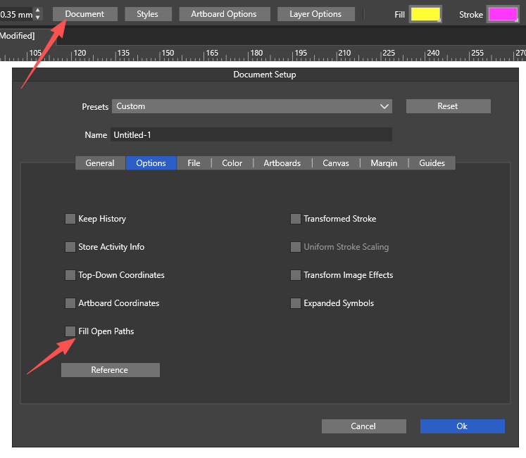

          I am using knife splitting, opening contours at nodes, closing, joining etc. all the time too.
          Is part of the problem that assigned Fills will show, even when the Path is open?
          • Is there an option - or can we have an option - to show or not Show Fills for Open Path?
          BR / Lars Herold
          • L Offline
            Li Xiao @larsherold
            @larsherold This option already exists.
            L 1 Reply Last reply Reply Quote 2
            • L Offline
              larsherold @Li Xiao
              @Li-Xiao , ah! Of course it's there😊 πŸ‘ .
              A Document Option, one place I didn't look!
              Thanks!
