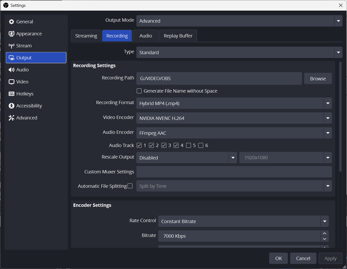

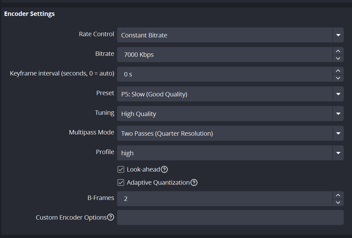

                        @Boldline I have 5 drives installed and most are "fat drives" so a good storage solution for general media storage and backups. An external would be fine also. I record to one of the drives as I work to a folder set for OBS recordings and I delete older recordings overtime just for clean up.

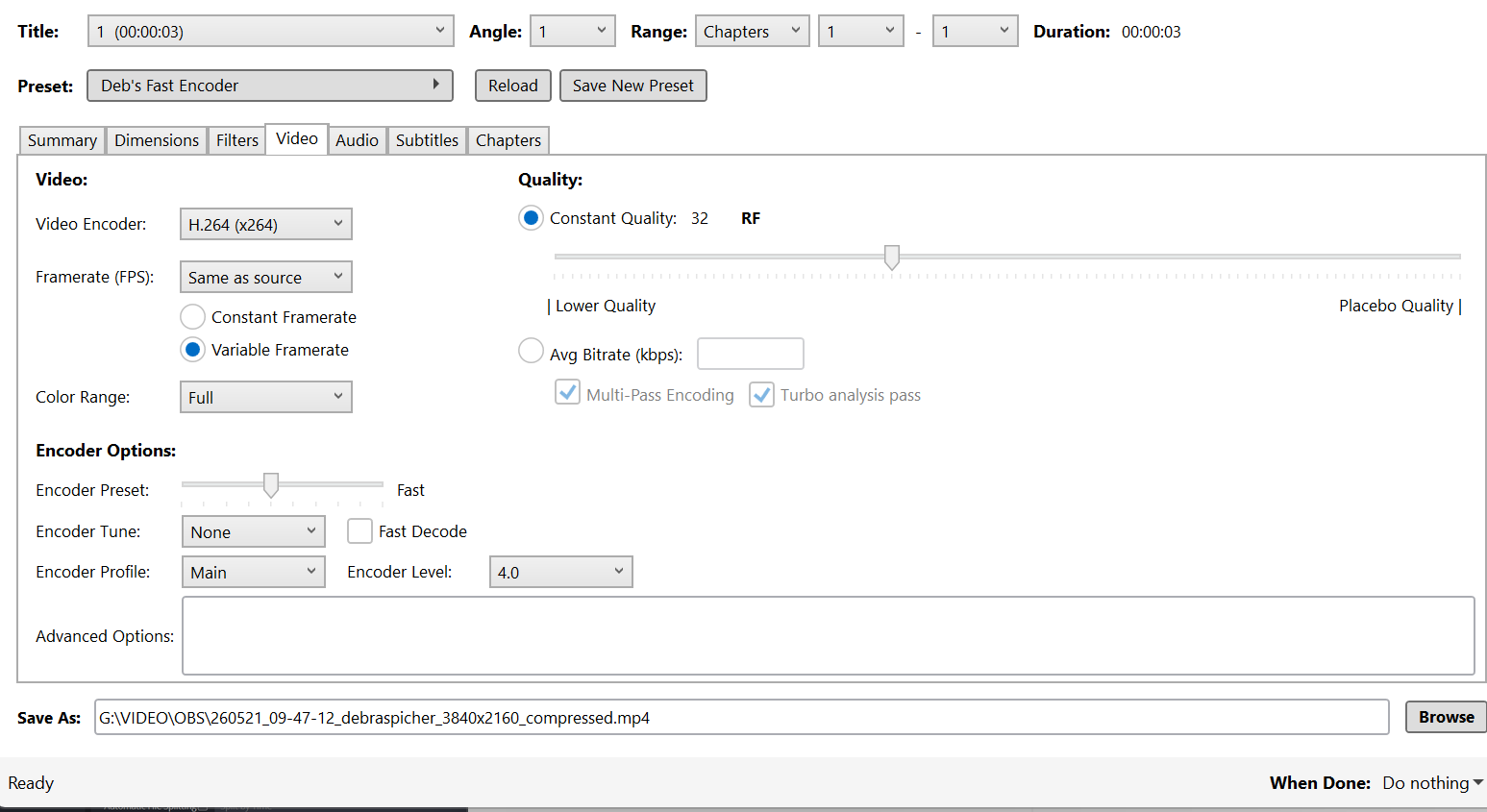

                        I'm recording 1080p/4K at 60fps depending on the situation in OBS and then I run something like Key n' Stroke for showing onscreen keys/clicks. I drag and drop the video files into Handbrake afterwards so I'm not sharing massive files. It does a great job of keeping the files slim and then I upload them to Onedrive where I have a folder separating different reports and sample files.

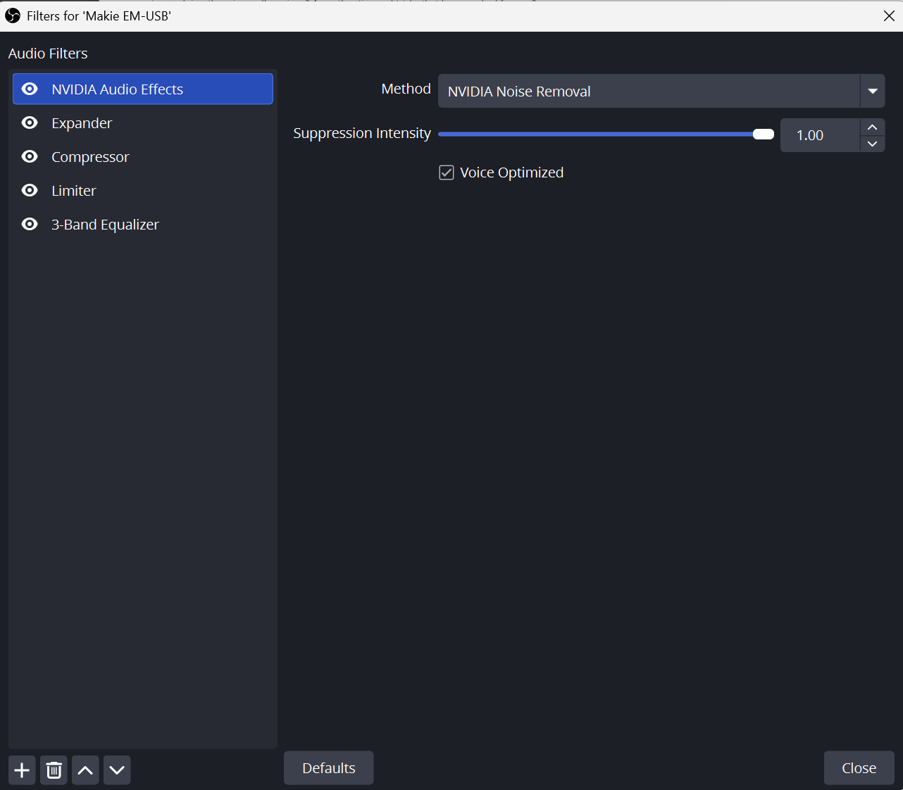

                        I have a dynamic condenser mic which I have tuned but a vast majority of that is for personal recordings rather than for streaming... I recommend if you get a "good mic", setup filters so that it's not picking up everything in your vicinity. It does not need need to be hundreds of dollars. Mine is a $70-80 Mackie with the proper software filtering to block out all the noise in my local environment.
                        If you have an Nvidia GPU, do take advantage of that also and use their filters which are pretty darn great...
                        This is a good introductory to setting up OBS mic filters:

                        Here are my OBS "Recording" settings:

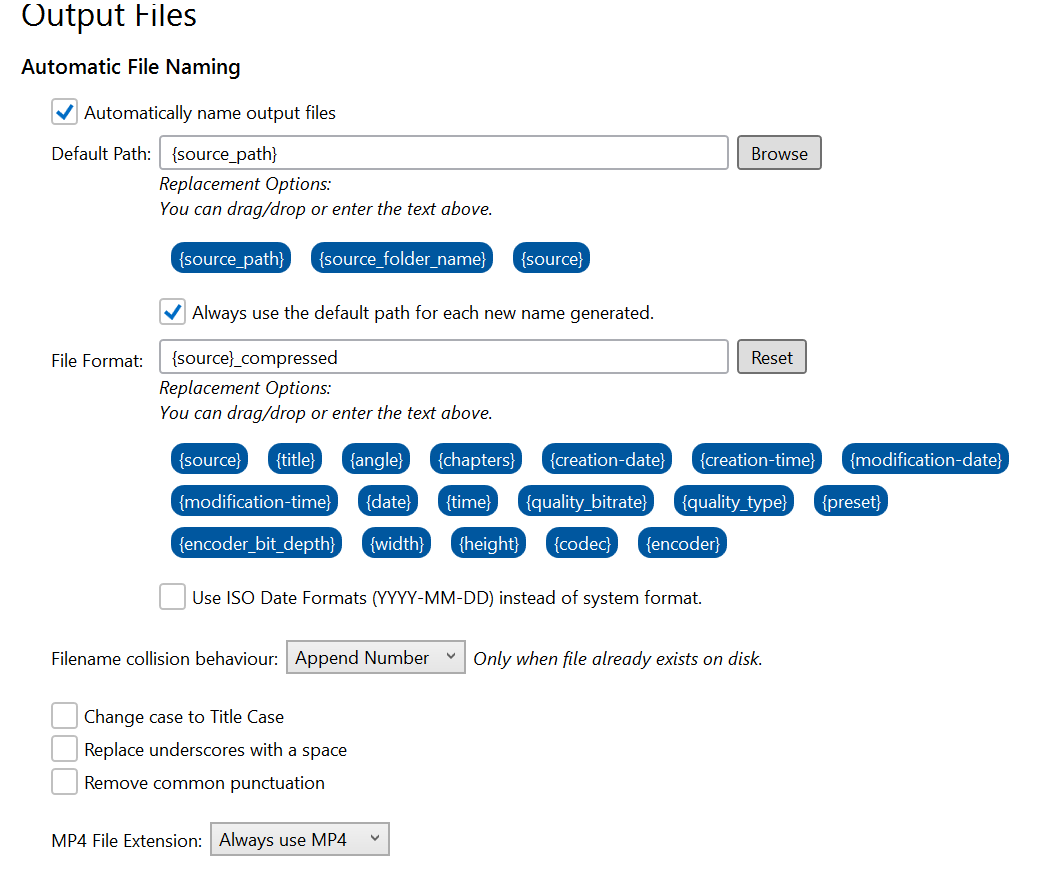

                        Handbrake is fairly straightforward to adjust. Most people use mp4. The only thing I changed is I set it to "compress" my files locally and keep them in the same folder with a suffix:
                        Preferences > Output Files
