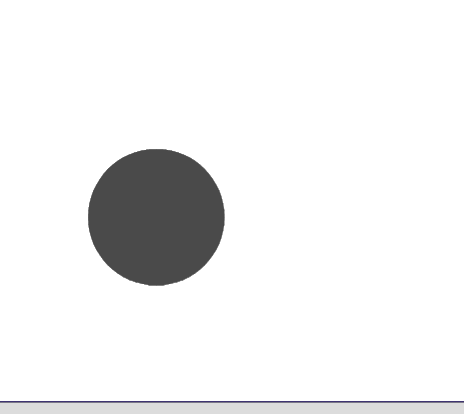

      When importing files containing svg patterns, VectorStyler did not render the pattern as expected (nor did Affinity, but Inkscape did render correctly). Is there a setting I missed ?
      By pattern, I'm referring to a pattern which can be defined in defs and applied to multiple shapes as a url fill. Like defined in : https://developer.mozilla.org/en-US/docs/Web/SVG/Reference/Element/pattern
      Test file : 0_1768562670337_test_svg.svg
      zipped : 0_1768562757314_test_svg.svg.zip

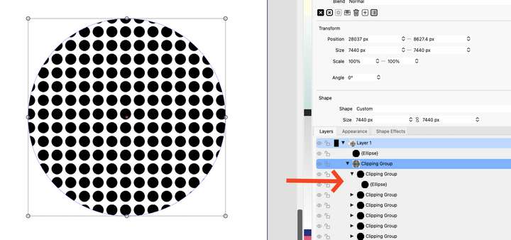

          After expansion of the pattern into a clipping mask, the object becomes slow to manipulate or recolor. On larger design files, the application simply removes the pattern upon expanding it, or freezes.
          Here is an example of a design where VS doesn't expand the pattern at all (leaving it blank) : 0_1768727368297_exported (40).svg.zip

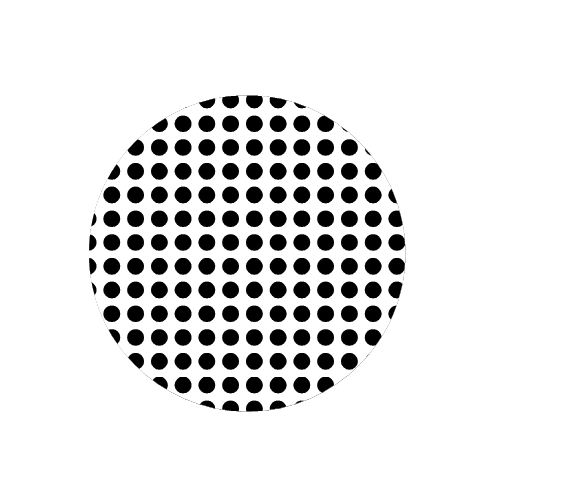

          I noticed that imported svg patterns expand into a much more nested grouping structure than native VS patterns, which could explain the slowness
          Native VS dot pattern after expansion
          2/ render (minor) : imported patterns don't render well, until the canvas is zoomed. Rendering comes and goes as we work on the document and zoom in and out. Not a major issue but would be nice if it could be improved

              @EricP I can replicate this last error with the slowdown. The object that was filled with the pattern is large and when expanding creates a lot of small clipping groups.
              This is slow to render for now.
              I will try to improve this later, but for now I have no solution for this.
              The grey fill at zoom out is just for display, the level at which this happens can be set in display options.
