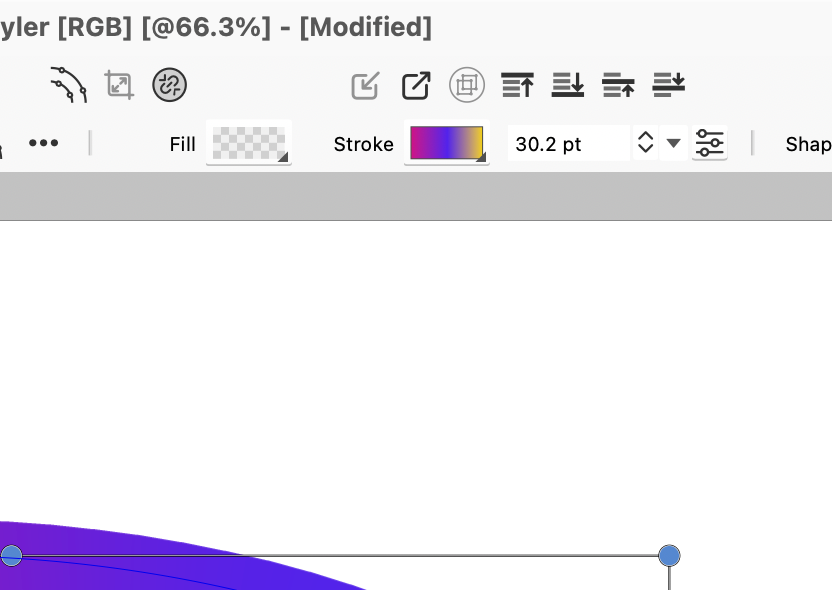

          @VectorStyler I'm not sure about what the OP was asking but I'd like to apply the gradient where one end is the start of the stroke and the other end is at the end of the stroke. I can't seem to get this when using a gradient in stroke mode. It only allows me a number of choices (linear, radial, spiral, etc.) none along the stroke itself.

            @Comet Is this what you need ? https://share.cleanshot.com/5gCFrKGg
            Also the file: gradientonstroke1.vstyler

              @VectorStyler Thank you, that's exactly what I was looking for. I had thought it would appear in the first box here, didn't realize you could one stope further:
