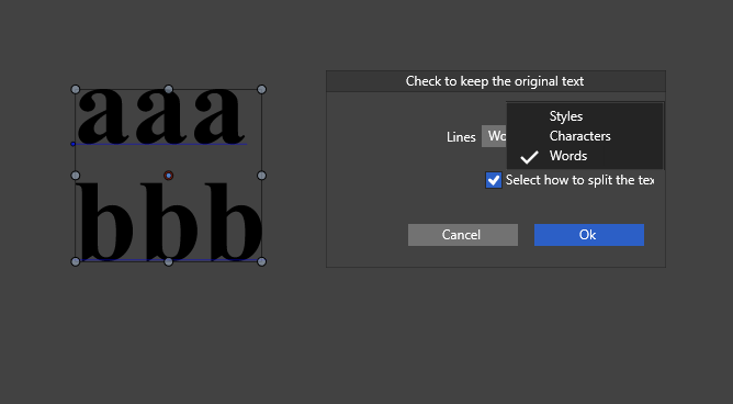

      The splitting into lines disappeared after the lastest update.

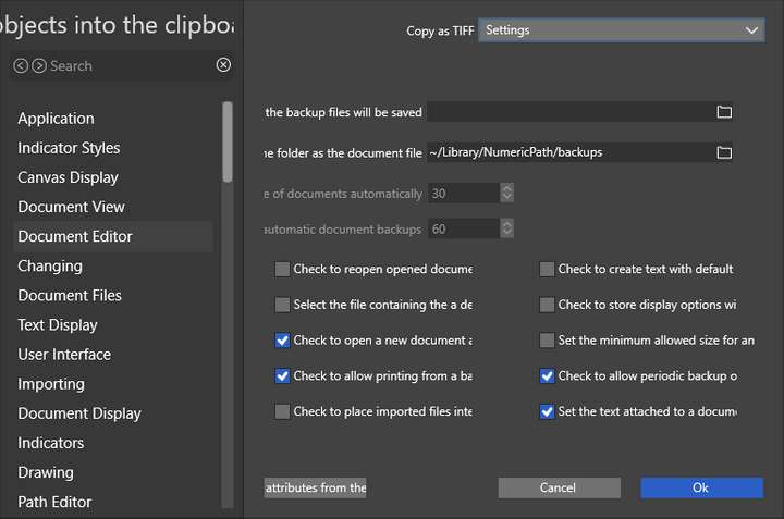

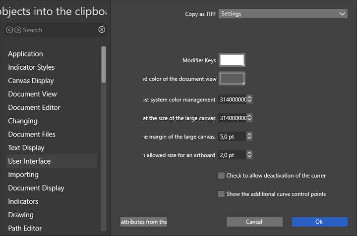

          @VectorStyler I have followed your list step by step. Only the last one made the problems disappear. The problem with the interface occurred in many places.0_1711750767562_screenshot_20240329_230041.png 0_1711750781342_screenshot_20240329_230001.png
