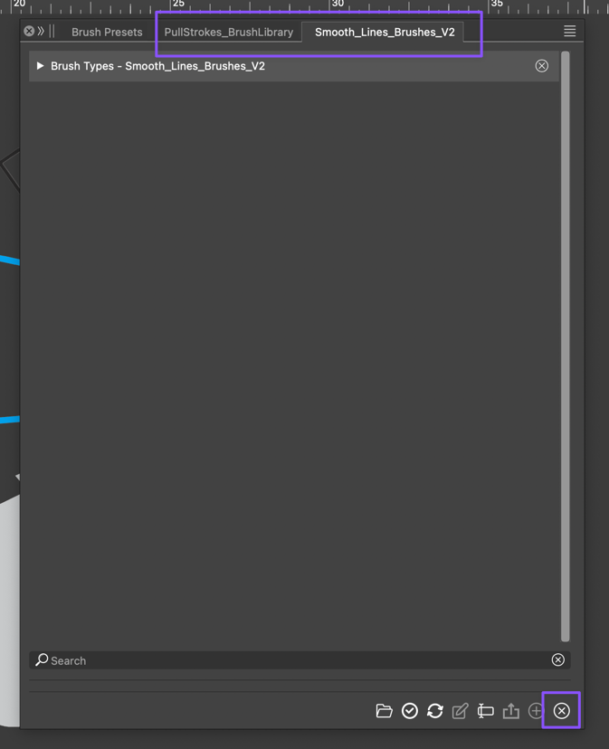

  • Currently, each new brush set I open in the "brush preset" panel opens in a new tab instead of being added to the list in the existing main brush preset panel. I do not understand the value in doing this, but I am open to learning how this is most useful. Also, those tabs do not see to be able to be closed out. Everything I have tried has not worked. Ideally I could just have the brush sets listed in groups and such in the main "brush preset" panel with the option to open any group or highlighted brushes in a new tab as needed.
    0_1703455455989_b77b68e1-33d8-470c-ba97-40494f6325c3-CleanShot 2023-12-24 at 17.01.42.png

    These brushes can be drag&dropped into the main brush set after opening them.
    Or: with a brush folder selected, select the Append command from the Brush presets panel menu and select the AI file to import brushes from.
