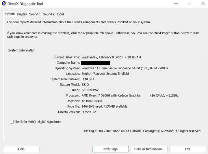

@Subpath and @b77 , I have restarted my laptop after installing v1.1.077 on the latest version WIndows 11 and here is my laptop system:

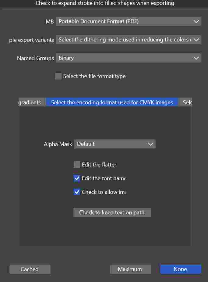

And clicking the Link File button shows export options instead of opening the link window. There is no close button and some tabs are not selectable:

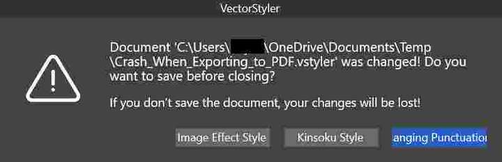

And if I close an altered document without saving it first, the warning window shows some weird options as well. There is no close button as well:

@gotanidea Looks like there are some issues with the resources.
Try removing the VectorStyler user data, by holding Control+Alt+Shift when starting VectorStyler

@gotanidea The way this looks like is that the update did not remove the old resources (this should be done by the Microsoft Installer / MSI).
So an other thing to try is to completely remove VectorStyler and reinstall.
And also manually remove VectorStyler user data from the c:\Users<user name>\AppData\Roaming\NumericPath\ folder
The "AppData" folder is hidden, and the "Roaming" can be "Local" depending on how it was installed.Somewhere the old resource files persist.

It works. Thanks
@gotanidea This issue should be fixed in build 1.1.080
