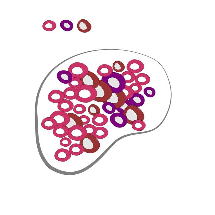

  • @EricP There are amazing videos and are very helpful. Need some help here for a project.
    I am trying to pack the three objects in the shape. I am not able to figure out how to add space and spread objects of variable shapes and sizes in random mode. Kind of circle packing but with objects.
    Attaching the file here.
    0_1763354384477_Repeater.vstyler
  • @Kumr yes there is no circle packing option in VectorStyler, at least yet. It was requested but it's quite complex to implement.
    I tried to modify your file but could not get to satisfactory design.
    I tried the following :
    1- use grid pattern instead of random, to have control on spacing, then use "adjustement" settings in additional repeater settings to randomize a bit the position and rotation
    2 add a transparent circle to each shape to impose some spacing on the random distribution, but it did not have an effect (2nd canvas)
    maybe others will have better ideas
    0_1763362871384_1763354385554-repeater2.vstyler

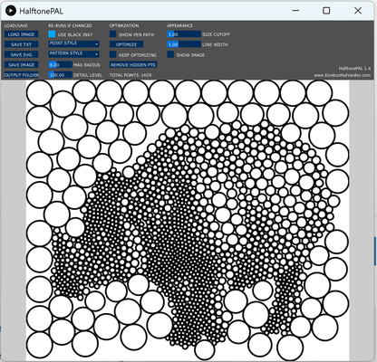

  • @EricP , @Kumr
    There is a little Circle Packing Tool here:
    https://github.com/ehufsted/HalftonePAL
    You can export the file as an SVG.
    Import it into VSt.
    Ungroup all and fill all with the same color.
    Then, use the "Colorize" with only three colors and select "Randomize."
    After that, you can select the objects by their color
    and modify them, resize them, or do whatever you want.
