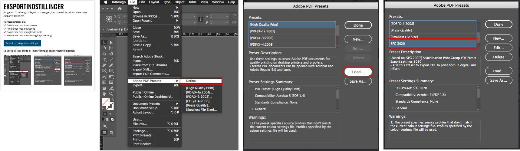

<?xml version="1.0" encoding="UTF-8"?><rss xmlns:dc="http://purl.org/dc/elements/1.1/" xmlns:content="http://purl.org/rss/1.0/modules/content/" xmlns:atom="http://www.w3.org/2005/Atom" version="2.0"><channel><title><![CDATA[Specifications for PDF-export for printing service]]></title><description><![CDATA[<p dir="auto">This is generel upload spec information provided by a Danish printing service (<a href="https://lasertryk.dk/downloads" rel="nofollow ugc">https://lasertryk.dk/downloads</a>). Can you tell how to load the mentioned “SPG 2020.joboptions” into VS?</p>
<p dir="auto"><a href="/forum/assets/uploads/files/1790846099287-spg-2020.joboptions.zip">SPG 2020.joboptions.zip</a></p>
<p dir="auto"><img src="/forum/assets/uploads/files/1790846119849-3426fb87-dc6e-4134-b42d-84828dfbbb80-image.png" alt="3426fb87-dc6e-4134-b42d-84828dfbbb80-image.png" class=" img-fluid img-markdown" /></p>

<p dir="auto">This cannot be loaded into VS. These are Adobe PDF Distiller specific options.</p>
<p dir="auto">The only thing that can be done is to set the printing options as close as possible and save that as a preset.</p>
