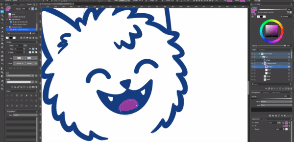

<?xml version="1.0" encoding="UTF-8"?><rss xmlns:dc="http://purl.org/dc/elements/1.1/" xmlns:content="http://purl.org/rss/1.0/modules/content/" xmlns:atom="http://www.w3.org/2005/Atom" version="2.0"><channel><title><![CDATA[Buggy Behavior in Colors Palette Panel + Undo]]></title><description><![CDATA[<p dir="auto">Hello, just wanted to bring a heads up to what appears to be a bug in version <code>1.3.018</code>.</p>
<p dir="auto">I recently discovered global colors, which is itself an extremely useful feature. I decided to start using it across my current project, as it was exactly what I needed for characters that needed consistent colors across the hierarchy.</p>
<p dir="auto">Unfortunately I've found the palette very difficult to work with.</p>
<ul>
<li>When I create a color, selecting it in any way applies the color wholesale even to layers I do not have selected.</li>
<li>Something gets messed up in how it pushes to the Undo/Redo stack, also, because pressing Ctrl-Z often skips over the layers it applied the color to and goes to previous steps (though this is not consistent). I often end up needing to remove the color manually and set it back to the original global color I had set.</li>
</ul>
<p dir="auto">In testing, when I tried to create a new color, clicking on it overrode my already-created global colors on any objects that used them.<br />
I've included a shot of the bug in action. Note that I have a single layer selected, the one I wanted to color (the tongue).<br />
<img src="https://i.gyazo.com/5b559c53620bd842869fc87b99d16c2a.gif" alt="alt text" class=" img-fluid img-markdown" /></p>
<p dir="auto">If this is not a bug and I'm using this wrong somehow, then I'm happy to correct whatever I'm missing. It is a very useful feature that I'd absolutely want to incorporate in future projects.</p>
]]></description><link>https://www.vectorstyler.com/forum/topic/5789/buggy-behavior-in-colors-palette-panel-undo</link><generator>RSS for Node</generator><lastBuildDate>Fri, 15 May 2026 17:12:43 GMT</lastBuildDate><atom:link href="https://www.vectorstyler.com/forum/topic/5789.rss" rel="self" type="application/rss+xml"/><pubDate>Thu, 14 May 2026 05:07:08 GMT</pubDate><ttl>60</ttl><item><title><![CDATA[Reply to Buggy Behavior in Colors Palette Panel + Undo on Thu, 14 May 2026 06:27:50 GMT]]></title><description><![CDATA[<p dir="auto"><a class="plugin-mentions-user plugin-mentions-a" href="/forum/user/dreams" aria-label="Profile: DreamS">@<bdi>DreamS</bdi></a> If the color is applied while nothing is selected then it is abug.</p>
<p dir="auto">Please send me a file to csraba at <a href="http://vectorstyler.com" rel="nofollow ugc">vectorstyler.com</a> where this kind of issue occurs.</p>
<p dir="auto">Also: the screenshot is too small to see, but it would be good to know what other panels are open.</p>
<p dir="auto">You can save your workspace with the icon at the end of the context panel row, and send that to me also so I can replicate the full thing</p>
