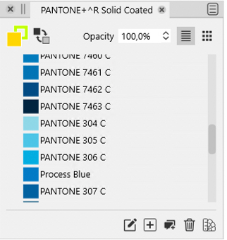

It would be useful to have search supported in palette, especially when using PANTONE and other spotcolor palettes that have named swatches:
If possible, this could be also in the version that can be accessed from the toolbar.
As I was writing this I noticed that you DO have a search field (accessible in context of sorting, which would also have solved the problem as it helps to locate a color) -- well, of course you do! But could the app remember the state of the search field, as now it seems that it needs to be invoked again each time the palette panel is opened?

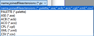

@Arde I noticed an error in that screenshot: the All Formats label resource was not defined
will be fixed in the next build. -

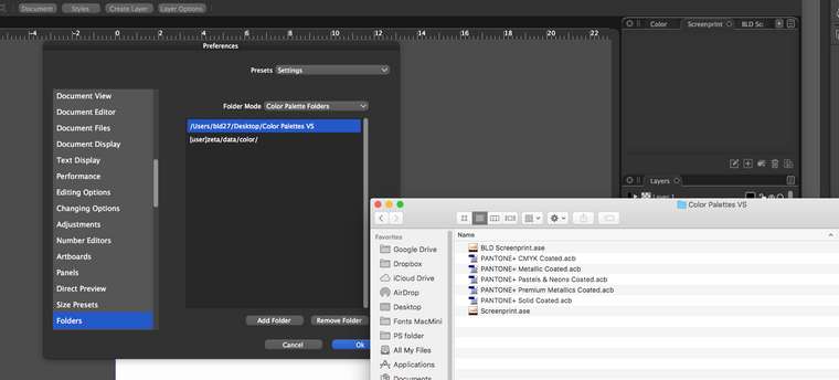

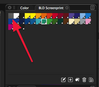

However, when I saved out my custom swatch palette from Illustrator as an ase file, when I open it in VS, it shows as empty. The screenshot I included shows the folder I'm using to store my palettes I want to use in VS, along with the preferences box in VS, and the empty palette panel . Am I missing something?
Also, when I first open VS, how do I set the default color palette? I can't tell by clicking on things what palette is being used initially. For example, I'd love for it to be set to the ase swatch file I exported from Illustrator. thanks!
@Boldline Is it also empty when opened with Panels -> Palettes -> Open Palette File. If so it could be some bug when reading the ASE file. If you send me that ASE file, I will try to find out the issue.
@vectoradmin Yes it is also empty when opened with Panels -> Palettes -> Open Palette File.
I'll email you the ase file - thanks! -
@Boldline Got the file, and it looks like there is a problem when reading this ASE file. The problem has been identified, and the fix will be in the next build.
@vectoradmin Awesome. Glad you were able to find the problem. I curated a palette of colors I use daily in my work and it's great that I can transfer that set over for use in VS. Ideally, I want to make that ase file my default set of colors that opens each time in VS

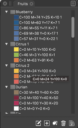

I tested this by exporting a palette with AI Fruits palette included in swatches, and VS imported that without any problems both on macOS and Windows. The source was created on Windows using AI CS6.
Is the error related to later version of AI, or having something unexpected in the swatches? I suppose AI automatically excludes gradients and the kinds of swatches that are not supported in an ASE file?
