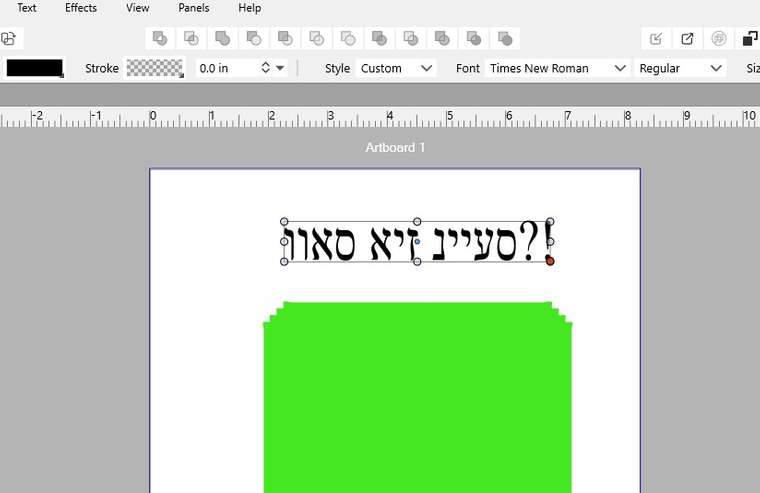

        • G Offline
          galmg @VectorStyler
          @vectoradmin
          Please check the image I uploaded, Do you know how to fix that?
            VectorStyler @galmg
            @galmg Send me that vstyler document by email containing both without and with fixer. I need to understand what is transformed there. Thanks!
              VectorStyler @galmg
              @galmg If you select the first (with RTL paragraph direction mode) and check the Medial Forms in the Text -> Typography panel, is it transformed?

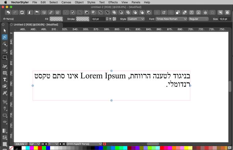

                VectorStyler @VectorStyler
                @vectoradmin There are some improvements to RTL language support in build 1.0.027, including better defaults.

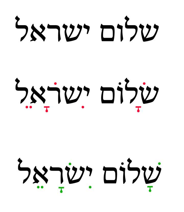

                  I was very excited to learn about VS and see that RTL is now supported, and tried it. It works (in a limited way) in Hebrew, but only for the letter forms (consonants). Vowels are small dots and dashes added to texts, similar to diacritics in other languages, I suppose. These require precise placement, and I tried in a variety of fonts and got inconsistent, but generally poor results.
                  As a professional Hebrew typesetter, this is not suitable for any work that I require.
                  Here is the bad (in red) and the manually corrected (green). This is using the public domain SBL Hebrew font: !0_1637686531767_Screen Shot 2021-11-23 at 11.28.38 AM.png
                    Boldline @baruch.sienna
                    @baruch-sienna That's really interesting to see (aside from it being helpful to improving RTL function in VS. It sounds like with your knowledge as a professional Hebrew typesetter you'll be able to add a lot of value and help to improving RTL function in VS

                      @Boldline I'd be happy to help; I've done some font/ software development, too. Hebrew vowels (like in Arabic), and unlike in English, are not totally necessary in many texts; still, some texts require them, and many Hebrew fonts include vowels. It is up to the font designer to make sure that the glyphs match up (not an easy task), (I've designed a number of Hebrew fonts, and dread making them with vowels because it is quite an arduous task). Still, once the font is properly designed, the word processor (or in this case, graphic app) should display the vowel placement correctly. I'm happy to test future versions, or give you pointers on placement, on how it SHOULD look. Just finishing the final touches on a 200 page Hebrew/English volume.
                      BoldlineB VectorStylerV 2 Replies Last reply Reply Quote 1

                          • B Offline
                            baruch.sienna @VectorStyler
                            @vectoradmin I would suggest you look at the SBL font that has the full set of vowels and other diacritic marks. If you have that font working, then everything else should work!
                            They provide it as a TrueType font:
