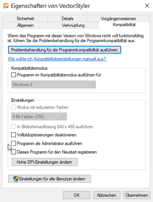

I had an idea about that, that you might try out.
How about checking if the .exe file have the option to "run as admin"
and if it does, then set it to "run as admin" and create then a
desktop icon from it. Maybe this could work.
@Gremriel The goal is to not need to run as admin.
@VectorStyler Yes, that is my preference as well, of course. And the latest version works as expected now. Just thought it was odd that the VS desktop icon is the only one of my desktop icons without that option. But it isn't needed anymore, so I consider this issue closed. Thanks again for the quick fix.
