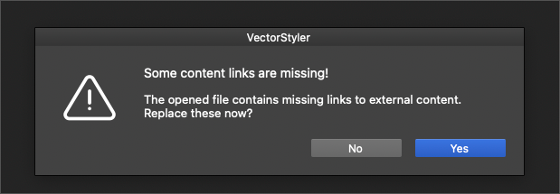

      I did not realize this change had occurred where the default was now to link instead of embed, so I have a number of files from the past week or so that all give me link break warnings every time I open them.
      Is there currently a way to know what in the file needs to be reconnected? For files that are accidentally and unknowingly linked to source material that is no longer possible to re-link to? For example, when I have used a 3rd party vector trace and dragged in the result into VS, that trace result is not saved in the third party app to link back to - it's only "staying alive" because I dropped it into a VS file for use there.
      What do I need to do with files asking for a re-link when I never intended there to be a link to begin with? @b77 mentioned he thinks 'Expand Content' is equivalent to AI's 'Embed' button; would I need to select everything in the file with the broken link and use "expand content" to be sure there are no hidden objects with broken links?

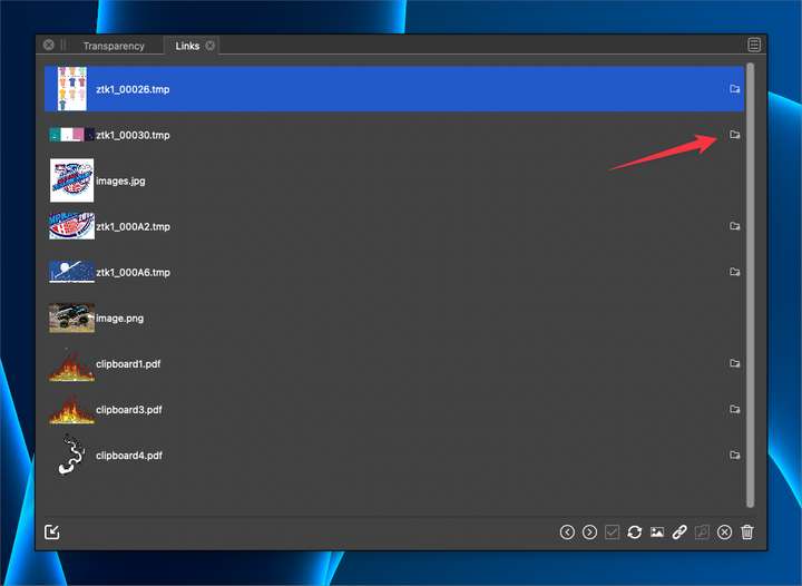

            I found the documentation on the links panel - really in depth and powerful tools in there. I feel like more could be done to make it easy to follow as a user, but I will check this more often to be sure I don't have link issues
              What do these icons here represent? I did not see that in the documentation
              0_1675468406455_a501eae4-2e9d-4ad1-aec4-f310231f072d-BLD 2023-02-03 at 18.52.43.png
              VectorStylerV b77B 2 Replies Last reply Reply Quote 0
                @Boldline Indicates that the link is missing.
