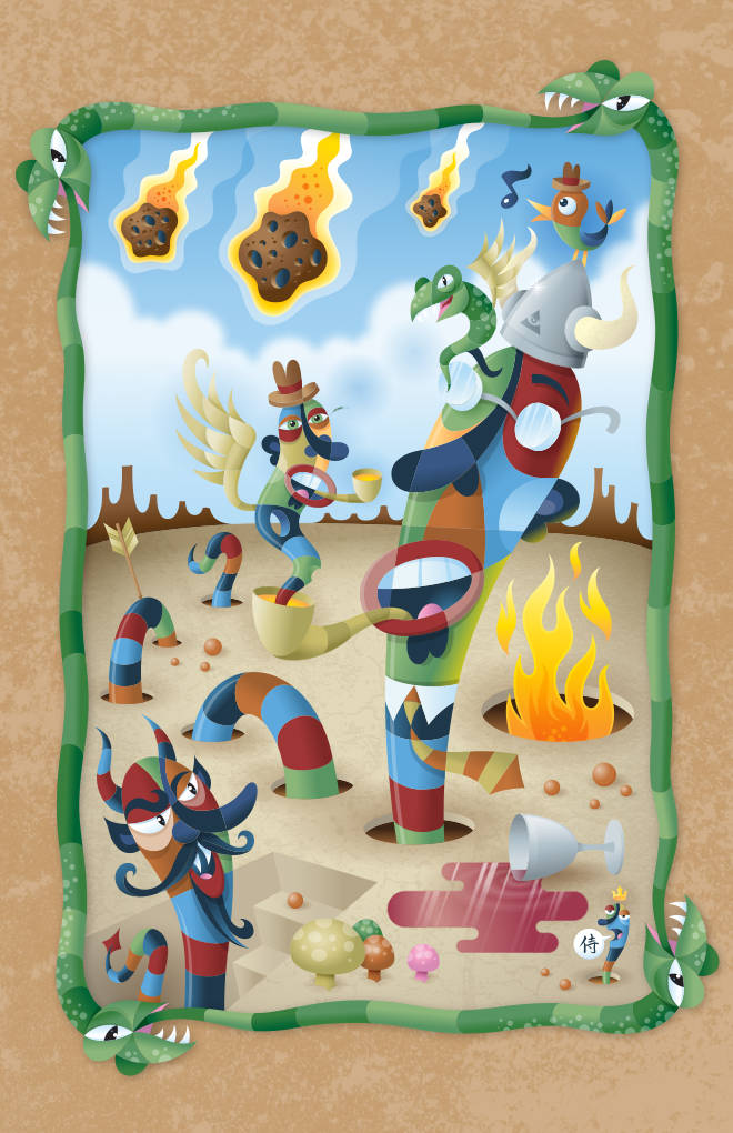

<p dir="auto">I always test with the following AI/SVG demo file:</p>
<p dir="auto"><img src="/forum/assets/uploads/files/1671780783766-wormwood_test.jpg" alt="0_1671780782603_wormwood_test.jpg" class=" img-fluid img-markdown" /></p>

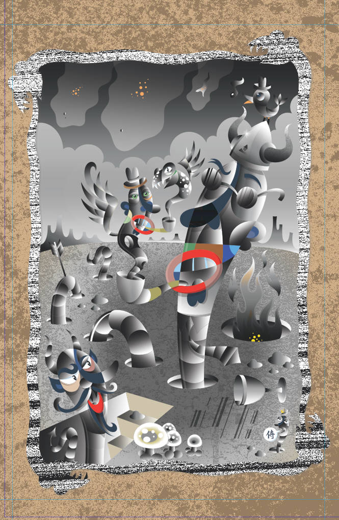

<p dir="auto">Loading the AI file in VS results in:<br />
<img src="/forum/assets/uploads/files/1671780991221-ai_result.jpg" alt="0_1671780990072_AI_result.jpg" class=" img-fluid img-markdown" /></p>
<p dir="auto">The file loads in a second in Affinity Designer without issues. PhotoLine and Inkscape will not load the AI, and I converted it to SVG in Designer</p>

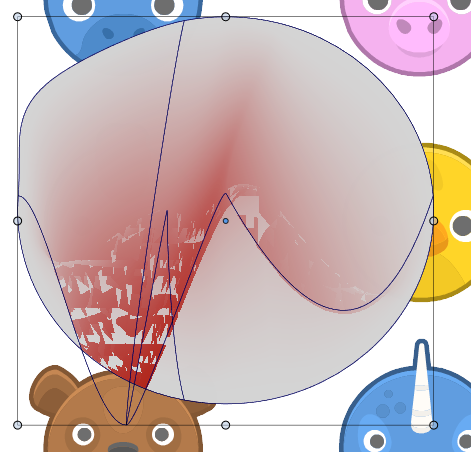

<p dir="auto">Lastly, I encountered view corruption of images and mesh gradients (also seen in one of the screenshots above):</p>
<p dir="auto"><img src="/forum/assets/uploads/files/1671784751455-corruption_mesh.png" alt="0_1671784750385_corruption_mesh.png" class=" img-fluid img-markdown" /></p>

<p dir="auto">As for the AI file: some features are not (yet) supported, there will be improvement in the future.</p>

<p dir="auto">The overlapping gradient mesh issues will be fixed later.</p>
